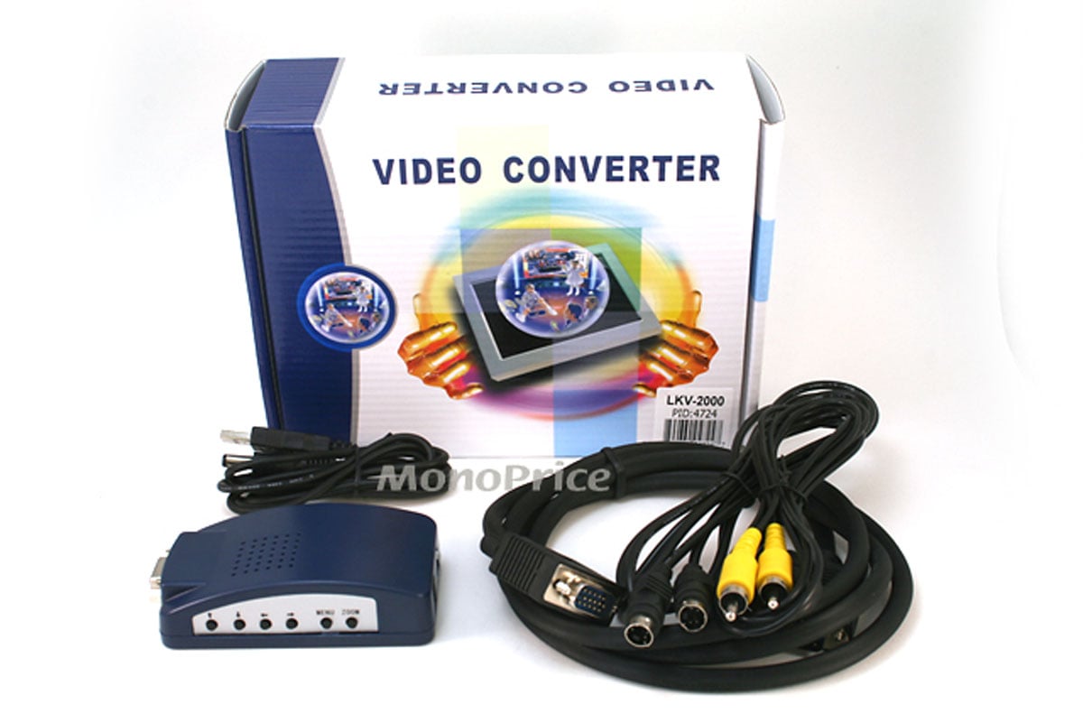

I have a ten year old, but perfectly good, Sony KV-25C5D Trinitron TV (CRT) with S-Video input sockets, SCART input sockets and Composite Video input sockets. At the moment it is connected to a Sagem Freeview (terrestrial digital TV) set-top box. I don't want to get rid of the Sony TV as it works fine, so I'll need to buy a VGA to S-Video adapter.
Any advice from someone with actual experience of doing this would be really appreciated. Thanks in advance.

To display the output of the nettop on my old Sony TV (which only has a choice of SCART, Composite Video and S-Video inputs) I use a VGA to RCA/S-VIDEO/VGA converter (manufacturer Lenkeng, model LKV-2000) to connect the 15-pin VGA socket on the nettop to an S-Video socket on the TV:
and a good-quality stereo 3.5mm jack plug to twin phono RCA lead, gold, 1.5M to connect the stereo 3.5 mm jack socket on the nettop to two RCA audio sockets on the TV.
