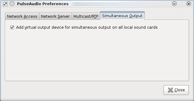

# eix paprefs
[I] media-sound/paprefs
     Available versions:  0.9.6 (~)0.9.8 (~)0.9.9 {nls}
     Installed versions:  0.9.9(23:58:11 18/12/09)(nls)
     Homepage:            http://0pointer.de/lennart/projects/paprefs
     Description:         PulseAudio Preferences, configuration dialog for PulseAudio

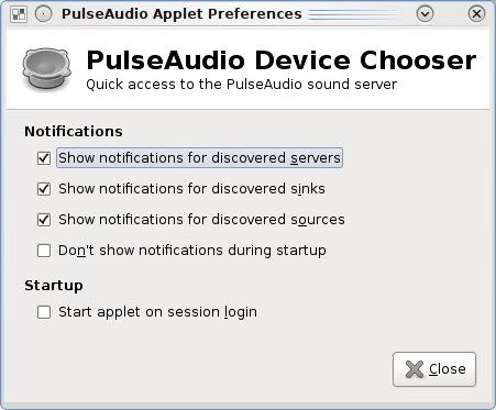

[I] media-sound/padevchooser
     Available versions:  0.9.3 (~)0.9.3-r1
     Installed versions:  0.9.3-r1(00:01:28 19/12/09)
     Homepage:            http://0pointer.de/lennart/projects/padevchooser/
     Description:         PulseAudio Device Chooser, tool for quick access to PulseAudio features

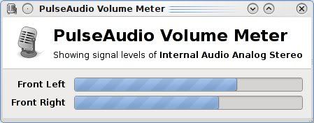

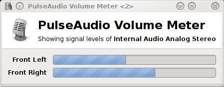

[I] media-sound/pavumeter
     Installed versions:  0.9.3-r1(00:01:47 19/12/09)
     Homepage:            http://0pointer.de/lennart/projects/pavumeter/
     Description:         PulseAudio Volume Meter, simple GTK volume meter for PulseAudio

7. And some screen snapshots:
Kickoff > Computer > System Settings > Multimedia (Audio Output Preferences)
Kickoff > Computer > System Settings > Multimedia (Audio Capture Preferences)
PulseAudio Applet > Preferences
PulseAudio Applet > Configure Local Sound Server... > Simultaneous Output
PulseAudio Applet > Volume Control... > Configuration
PulseAudio Applet > Volume Control... > Input Devices
PulseAudio Applet > Volume Control... > Output Devices
PulseAudio Applet > Volume Control... > Recording
PulseAudio Applet > Volume Control... > Playback
You'll notice from the screenshot above that I was using the media player JuK to play some music at the time.
PulseAudio Applet > Volume Meter (Playback)...
PulseAudio Applet > Volume Meter (Recording)...
Skype > Options > Sound Devices
KMix > Mixer
I have selected the Master radio button as the master channel (by using KMix > Select Master Channel...)
Let me know if you want to see the contents of any specific file, as I have not listed all the files with "pulse" in their name.
