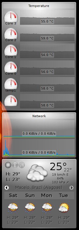

I'm using the Hardware Temperature widget by Petri Damstén, which comes as standard with KDE. In my case it shows the temperatures of the hardware I am using: the four cores of the Core i7 CPU plus two other temperatures, both of which are apparently the laptop's motherboard temperature. It does not see the HDD temperature, though, so I am also using GKrellM, which is not a widget per se but may as well be. See Re: Notebook running hot [Solved] for how to install the HDD temperature monitoring daemon.

In last days I tried your suggestions. That's the moments results:
I get displayed informations about cpu temperature and NVidia temperature.
For tests I have run the built in plasma plasmoid 'Hardware Monitor', which (only) shows the CPU temperatures.
Then there is the 'Simple NVidia Info' which works, but 2nd version, I can't install.
1. Then there is a widget with many informations, but I forgot the name and I can't change any settings (see attachm.)
2. And then there is your suggested GKrellM, which I installed also.
In both last programs, there is no harddrive temperature (0°) in widget window,
though when I start '/usr/sbin/hddtemp /dev/sda' I get a console result with (e.g.)
/dev/sda: WDC WD5000BEVT-22A0RT0: 37°C
In my eyes it seems, that hdd temperature is recognized, but can not be read by the plasmoids or widget or GKrellM.
'sensors_detect' does not detect and show me any hdd...
-Linuxfluesterer (I love KDE ...)

Yes, I see it now .. And this is mine now. Is it correct, that I must also start
hddtemp
every time I boot (so Autostart it)? Because only after start that program (not the daemon!) then I see the hdd temp.
Image Image
But in Oxygen System Monitor, there is still no display of (any) temperature (I hope, you can recognize on the photo).
I don't know, why there is a temperature in GKrellM and not also in Oxygen System Monitor (wether cpu nor hdd).
Any idea?
